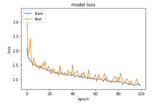

[EDIT] For example, I obtain this plot :
How do I interpret this?
From what I can see, it seems that the loss decreases both for train set and test set at the same rate, and we have that if this happens the model is good, otherwise we encouter overfitting or also underfitting. But I don't understand, why we have this? So why if the are close and decrease at same pace we are doing well, otherwise not?

Thinking in terms of optimisation, loss is convergence indicator
NN can be expressed as an optimization problem.
In the context of an optimization algorithm, the function used to evaluate a candidate solution (i.e. a set of weights) is referred to as the objective function. When we minimise this function we also refer to it as loss function
Cross-entropy and mean squared error are the two main types of loss functions to use when training neural networks.
Graph that you plotted indicates just convergance behavior on two different sets of our optimisation problem. If they diverge too much, we are overfitting. If they stop, we stopped learning.
