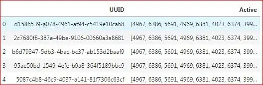

UUID Table
This is a subset of the whole table
shape = (2060590, 2)
UUID Table

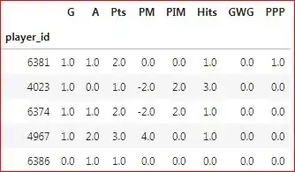

Player ID Table
shape = (39,8)
points table

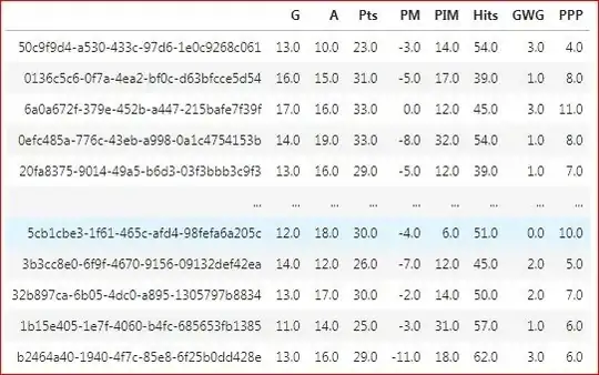

Final Table
final table
