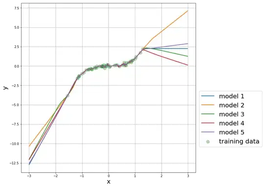

Let's look at a little example. I created a little toy data set and ran regression with the same network, same optimizer and everything the same, except the initialization.
All 5 models give the same prediction in the domain where there is data (they even over-fit a little bit in the same way). But for x-values far away from the training data, we get widely different predictions from different models.
So what does this tell us? It tells us that our models are basically worthless for inputs that are "far" from the training data. "Far" means "from a different distribution" in this sense. But if our models are worthless for inputs that do not come from the original distribution, then any quality measures based on test and validation datasets are also worthless.
