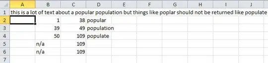

cells
Cell A1 contains the string, B1 has no formula, and if you run out of "n/a"s you can extend columns B, C, and D by filling down. The formulas are as follows:
B3 and below use
=IF(C2+1<LEN($A$1),C2+1,"n/a")
C2 and below use
=IFERROR(FIND(" ",$A$1,SEARCH("popul",$A$1,B2)),LEN($A$1)+1)
D2 and below use
=IFERROR(MID($A$1,SEARCH("popul",$A$1,B2),C2-SEARCH("popul",$A$1,B2)),"")
