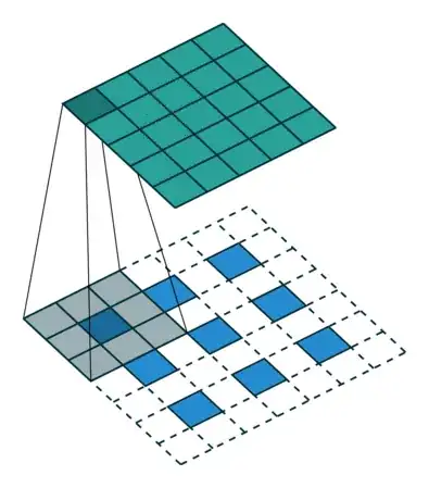

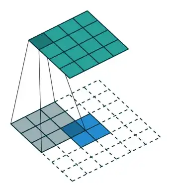

Deconvolution layer is a very unfortunate name and should rather be called a transposed convolutional layer.
Visually, for a transposed convolution with stride one and no padding, we just pad the original input (blue entries) with zeroes (white entries) (Figure 1).
Figure 1
In case of stride two and padding, the transposed convolution would look like this (Figure 2):
Figure 2
All credits for the great visualisations go to
You can find more visualisations of convolutional arithmetics here.

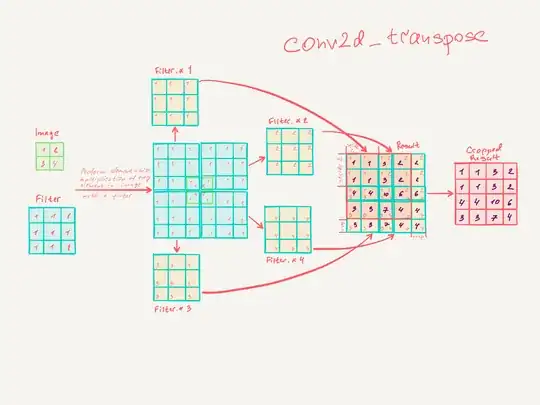

Step by step math explaining how transpose convolution does 2x upsampling with 3x3 filter and stride of 2:
The simplest TensorFlow snippet to validate the math:
import tensorflow as tf
import numpy as np
def test_conv2d_transpose():
    # input batch shape = (1, 2, 2, 1) -> (batch_size, height, width, channels) - 2x2x1 image in batch of 1
    x = tf.constant(np.array([[
        [[1], [2]],
        [[3], [4]]
    ]]), tf.float32)
    # shape = (3, 3, 1, 1) -> (height, width, input_channels, output_channels) - 3x3x1 filter
    f = tf.constant(np.array([
        [[[1]], [[1]], [[1]]],
    ]), tf.float32)
    conv = tf.nn.conv2d_transpose(x, f, output_shape=(1, 4, 4, 1), strides=[1, 2, 2, 1], padding='SAME')
    with tf.Session() as session:
        result = session.run(conv)
    assert (np.array([[
        [[1.0], [1.0],  [3.0], [2.0]],
        [[4.0], [4.0], [10.0], [6.0]],
        [[3.0], [3.0],  [7.0], [4.0]]]]) == result).all()

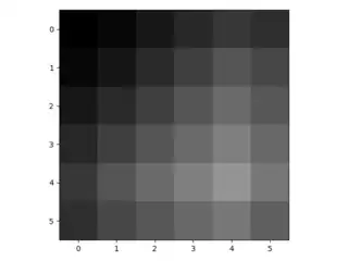

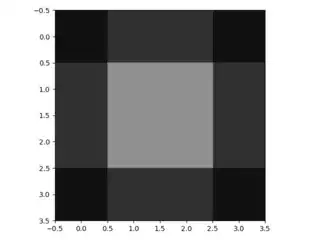

I had a lot of trouble understanding what exactly happened in the paper until I came across this blog post: http://warmspringwinds.github.io/tensorflow/tf-slim/2016/11/22/upsampling-and-image-segmentation-with-tensorflow-and-tf-slim/
Here is a summary of how I understand what is happening in a 2x upsampling:
Information from paper
Simple example
  1. imagine the following input image:
Input image
  1. Fractionally strided convolutions work by inserting factor-1 = 2-1 = 1 zeros in between these values and then assuming stride=1 later on. Thus, you receive the following 6x6 padded image
padded image
  1. The bilinear 4x4 filter looks like this. Its values are chosen such that the used weights (=all weights not being multiplied with an inserted zero) sum up to 1. Its three unique values are 0.56, 0.19 and 0.06. Moreover, the center of the filter is per convention the pixel in the third row and third column.
filter
  1. Applying the 4x4 filter on the padded image (using padding='same' and stride=1) yields the following 6x6 upsampled image:
Upscaled image
  1. This kind of upsampling is performed for each channel individually (see line 59 in https://github.com/shelhamer/fcn.berkeleyvision.org/blob/master/surgery.py). At the end, the 2x upsampling is really a very simple resizing using bilinear interpolation and conventions on how to handle the borders. 16x or 32x upsampling works in much the same way, I believe.

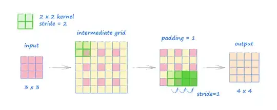

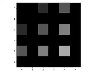

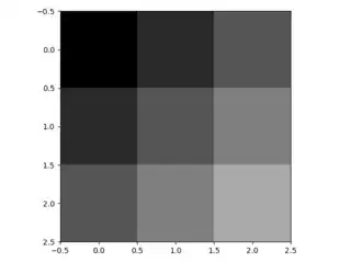

i wrote up some simple examples to illustrate how convolution and transpose convolution is done, and as implemented by software libraries like PyTorch
https://makeyourownneuralnetwork.blogspot.com/2020/02/calculating-output-size-of-convolutions.html
an example of the visual explanations:
Actual explanation

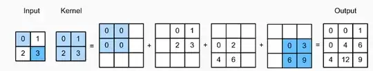

I've been digging trying to find a good explanation, and found most explanations sidestep the issue, by explaining the equivalent Convolution operation, instead of explaining what TransposeConv actually is (The same applies to all of the previous answers).
Every convolution can be described by an equivalent Transpose-Convolution, and vice versa. The kernel is simply transposed (and other parameters adjusted, e.g. $Stride_{conv} = 1/stride_{TransposeConv}$).
For some reason, most explanations and visualizations focus on explaining the equivalinet convolution, instead of the TrasposeConv.
Finally I've found a good explanation Here.[check it out for a more detailed explanation]
Most importantly, it has a good image explaining it all:
TransposeConv explained in a single image.
Put into words: TransposeConv takes each pixel from the input image, and 'blows it up' by the kernel. That means, each input pixel is multiplied by the kernel, and the result is placed (added) onto the output image.
Another important distinction here regarding the Stride argument, which will help explaining the difference between Convolution and Transpose-Convolution:
In Conv layers, Stride refers to the input image: the kernel is slid across the input image jumping Stride pixels over each time, but the result of each of these kernel multiplications is then stored at a fixed stride (of 1) in the output image.
In TrasposeConv though, Stride is referring to the output image. The kernel is multiplied by a single pixel from the input image at a set stride of 1, but the result is then added to the output image at a location "Stride" pixels away from the previous result. This has the effect of upsampling by a factor of roughly Stride, since each pixel has an effect Stride pixels away from its neighbors.
