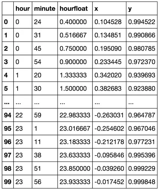

from pandas import DataFrame, read_csv df = read_csv('/Users/angus/Machine_Learning/ipython_notebooks/times.csv',delimiter=':') df['hourfloat']=df.hour+df.minute/60.0 df['x']=np.sin(2.np.pidf.hourfloat/24.) df['y']=np.cos(2.np.pidf.hourfloat/24.)
df

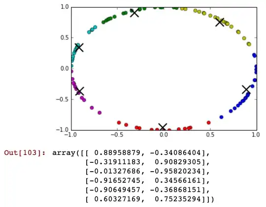

kmeansshow(6,df[['x', 'y']].values)
You can just barely see that there are some after midnight times included with the before midnight green cluster. Now lets reduce the number of clusters and show that before and after midnight can be connected in a single cluster in more detail:

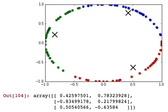

kmeansshow(3,df[['x', 'y']].values)
See how the blue cluster contains times that are from before and after midnight that are clustered together in the same cluster...
