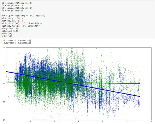

This strategy seems to work according to the following plot: enter image description here
X axis is the known input signal, Y axis is the output signal, blue and green dots represent the averaged data before and after applying the linear regression algorithm, respectively. Lines are the best fit for each data set.
You can see that the green line ("cleaned" dataset) has the smallest slope, meaning that the output variable is considerably less linearly correlated with the input than it was previously. Therefore, I assume that the regression technique explained before is working as expected.
My question, looking at the plot, is there any mathematical procedure to directly "project" the original dataset in a way that the correlation between the input and output variables is minimized? Is there any math trick to avoid the use of the regression technique on all the example datasets to obtain a similar result?
