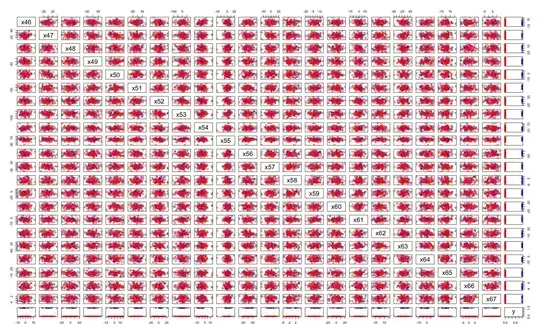

I am working with classification problem on a training data set, which have 100 features. All the features in pairs haven't visible correlation. One can see it in the example pair plot for the some of features:
I am trying to find the right way to decrease the number of features. All the methods of the important feature selection return different sets of features. For example:
