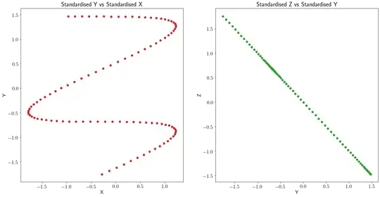

One of the assumption to measure Pearson correlation between two time series is called linearity, that when both series are plotted against one another on a scatter graph, there is a linear relationship:
Scatter Plot of Y vs X and Z vs Y
As you can see, $X$ and $Y$ do not satisfy this condition and so Pearson correlation is the incorrect statistical measure to use, whereas for $Y$ and $Z$ it is. Why though?

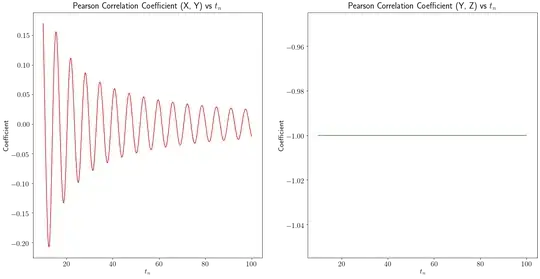

Pearson correlation measures the degree to which values deviate from the linear line of best fit between the two series provided. If the relationship is not linear, this relationship will not be measured accurately. This can be shown by plotting the Pearson correlation coefficient as $t$ increases:
Coefficient vs Time for XY and YZ
Notably, $X$ and $Y$ will also violate the assumption of a monotonic relationship for both Spearman and Kendall rank, and so you cannot measure correlation with any of these methods for $X$ and $Y$ unless transformations of the data are performed to satisfy the underlying assumptions - as you do in the question post.
Linear trends, therefore, don't have strictly positive or negative impacts on measuring correlation. You will just have to react accordingly to the underlying assumptions of the correlation measure you need to use.
