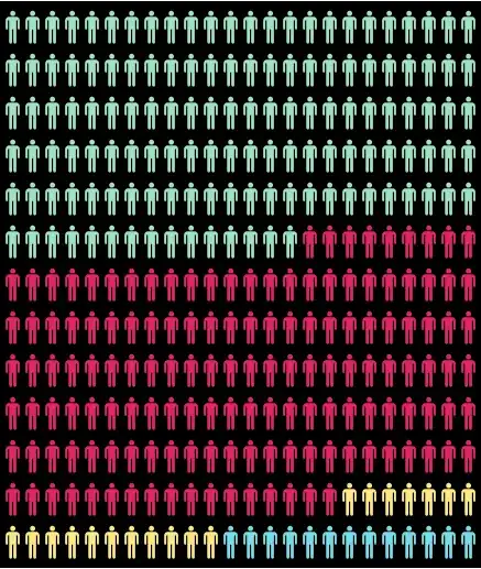

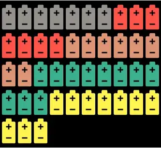

I really like how this visualization represents the survey participants.
Is any tool for that? (Or R/python library?)

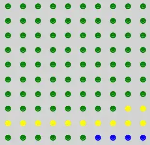

My go to library would be matplotlib, with which it is relatively easy to generate something similar.
I don't have the correct font family to render the exact output as above, but this hopefully illustrates the point
Source Code
import pandas as pd
import numpy as np
# Create the data to plot on
# create a 2d array of evenly-spaced points on a grid
xy_range = np.arange(10.)
data = pd.DataFrame([[x, y] for x in xy_range for y in xy_range], columns=['X', 'Y'])
# color the points
# all green first and then with exceptions
data['color'] = 'green'
data.loc[(data['X']>=0)&(data['Y']==1), 'color'] = 'yellow'
data.loc[(data['X']>=8)&(data['Y']==2), 'color'] = 'yellow'
data.loc[(data['X']>=6)&(data['Y']==0), 'color'] = 'blue'
# We'll use this to calculate axis fractions
max_x = data['X'].max()
max_y = data['Y'].max()
fig, currAX = plt.subplots(figsize=(5,5), facecolor='lightgray')
# plot/mark each point as an annotation
# we do this so we can get a custom emoji instead a marker
for x0, y0, color in zip(data['X'], data['Y'], data['color']):
    plt.annotate(s=u'\u263B', xy=(x0/max_x, y0/max_y), fontname='STIXGeneral', color=color, size=15, ha='center', va='center')
# clear the axis lables, ticks, and lines
currAX.get_xaxis().set_visible(False)
currAX.get_yaxis().set_visible(False)
plt.axis('off')
plt.show();
Anandologist
  • 441

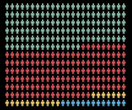

With Wolfram Language you may use "Icon" Entity and ConstantArray to create lists of "Crayola" ColorData colored icons and display with Multicolumn 24 columns wide.
palette = <|"SeaGreen" -> 135, "Razzmatazz" -> 146, "Yellow" -> 18, "TurquoiseBlue" -> 13|>;
Multicolumn[
 Flatten@
  KeyValueMap[
    With[{i =
        Graphics[{ColorData["Crayola", #1], List @@ Entity["Icon", "MensRoom"]["Image"]},
         Background -> Black,
         ImageSize -> 12]
      ConstantArray[i, #2]
    ]@palette,
 24,
 Spacings -> .2,
 Frame -> True,
 FrameStyle -> Directive[Thickness[3], Black],
 Appearance -> "Horizontal"
Mathematica graphics
Update
The above can be generalised into a function that takes an Association of colours to number of icons, a set of graphics primitives for the icon (icons are FilledCurves), and some additional display parameters.
ClearAll[iconChart]
Options[iconChart] = {Options[Multicolumn], Options[Graphics]};
SetOptions[iconChart,
   ImageSize -> 12,
   Spacings -> .2,
   Frame -> True,
iconChart[pallet_, icon_, columns_, opts : OptionsPattern[iconChart]] :=
 Multicolumn[
  Flatten@
   KeyValueMap[
     With[{i =
         Graphics[{#1, icon},
          Frame -> None,
          FilterRules[{opts, Options[iconChart]}, Options[Graphics]]]
     ]@pallet,
  columns,
  FilterRules[{opts, Options[iconChart]}, {Options[Multicolumn]}]
Then the above can be charted with
iconChart[
  ColorData["Crayola", "SeaGreen"] -> 135,
  ColorData["Crayola", "Razzmatazz"] -> 146,
  ColorData["Crayola", "Yellow"] -> 18,
  ColorData["Crayola", "TurquoiseBlue"] -> 13
 List @@ Entity["Icon", "MensRoom"]["Image"],
 24

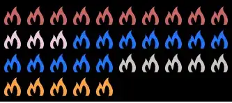

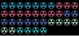

Adding random colour and icon selection generates a different chart on each evaluation.
iconChart[
 AssociationThread[
  RandomSample[
   Values@KeyDrop["Black"]@ColorData["Crayola", "ColorRules"], 5],
  RandomInteger[{3, 15}, 5]
 List @@ RandomEntity["Icon"]["Image"],
 10,
 ImageSize -> 30]
For example,
and so on.
Hope this helps.

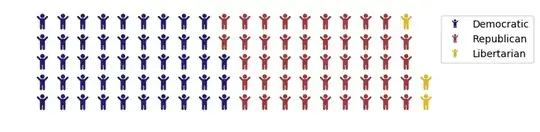

Waffle Chart
These are called Waffle Chart. A Waffle Chart is a gripping visualization technique that is normally created to display progress towards goals. A waffle chart shows progress towards a target or a completion percentage. There is a grid of small cells, of which coloured cells represent the data. A chart can consist of one category or several categories. Multiple waffle charts can be put together to show a comparison between different charts.
PyWaffle is an open source, MIT-licensed Python package for plotting waffle charts.
It provides a Figure constructor class Waffle, which could be passed to matplotlib.pyplot.figure and generates a matplotlib Figure object.
Some examples:
Plot with Icons - Pictogram Chart
data = {'Democratic': 48, 'Republican': 46, 'Libertarian': 3}
fig = plt.figure(
    FigureClass=Waffle,
    rows=5,
    values=data,
    colors=["#232066", "#983D3D", "#DCB732"],
    legend={'loc': 'upper left', 'bbox_to_anchor': (1, 1)},
    icons='child',
    font_size=12,
    icon_legend=True
plt.show()

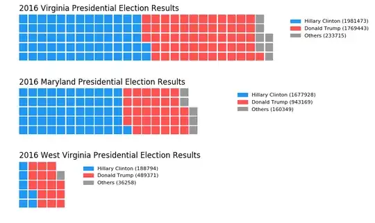

Multiple Plots in One Chart
import pandas as pd
        'labels': ['Hillary Clinton', 'Donald Trump', 'Others'],
        'Virginia': [1981473, 1769443, 233715],
        'Maryland': [1677928, 943169, 160349],
        'West Virginia': [188794, 489371, 36258],
).set_index('labels')
A glance of the data:
Maryland Virginia West Virginia
labels
Hillary Clinton 1677928 1981473 188794
Donald Trump 943169 1769443 489371
Others 160349 233715 36258
fig = plt.figure( FigureClass=Waffle, plots={ '311': { 'values': data['Virginia'] / 30000, 'labels': [f"{k} ({v})" for k, v in data['Virginia'].items()], 'legend': {'loc': 'upper left', 'bbox_to_anchor': (1.05, 1), 'fontsize': 8}, 'title': {'label': '2016 Virginia Presidential Election Results', 'loc': 'left'} }, '312': { 'values': data['Maryland'] / 30000, 'labels': [f"{k} ({v})" for k, v in data['Maryland'].items()], 'legend': {'loc': 'upper left', 'bbox_to_anchor': (1.2, 1), 'fontsize': 8}, 'title': {'label': '2016 Maryland Presidential Election Results', 'loc': 'left'} }, '313': { 'values': data['West Virginia'] / 30000, 'labels': [f"{k} ({v})" for k, v in data['West Virginia'].items()], 'legend': {'loc': 'upper left', 'bbox_to_anchor': (1.3, 1), 'fontsize': 8}, 'title': {'label': '2016 West Virginia Presidential Election Results', 'loc': 'left'} }, }, rows=5, # outside parameter applied to all subplots colors=["#2196f3", "#ff5252", "#999999"], # outside parameter applied to all subplots figsize=(9, 5) ) plt.show()
