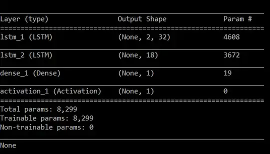

And I got the below summary details for this implementation.
I tried to understand the internal structure of these layers and how these layer numbers ( 32, 18,1) mapped with matrix. I got the below matrix size from the weight matrix.
I can not see any relation between the output size and the weight matrix :(

Now I am confused to find out the implementation logic inside the layer. Because I got three weight matrix in each LSTM layer and I can not connect the first LSTM(32) to the next LSTM(18) layer.
It will be thankful if any live implementation or flow diagram exists for this implementation. Thanks.
