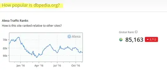

There is also the academic DBPedia project, an RDF version of a subset of Wikipedia.
According to the Alexa search engine, which ranks web sites according to their popularity on the internet, it is among top 100.000 of websites - not bad, not completely irrelevant.
General interest for the DBpedia.org website in the period 2015-2016 seems to have been fairly constant. See screen grab.
dbpedia timeseries 2015
Other similar sites (according to Alexa) are much less popular.
So I'd say Semantic Web Acceptance is not dead, it just smells funny.
