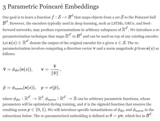

I did find a paper(pdf) that tried to do this, by reparameterizing the model, but I wasn't able to gauge from their description how to implement this. It does describe the problem neatly though.
