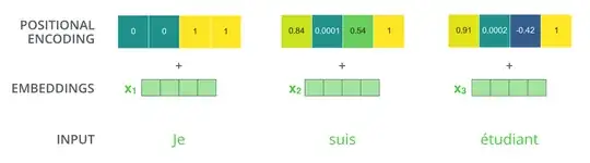

While reviewing the Transformer architecture, I realized something I didn't expect, which is that :
  • the positional encoding is summed to the word embeddings
  • rather than concatenated to it.
positional encoding summed to word embedding
http://jalammar.github.io/images/t/transformer_positional_encoding_example.png
Based on the graphs I have seen wrt what the encoding looks like, that means that :
  • the first few bits of the embedding are completely unusable by the network because the position encoding will distort them a lot,
  • while there is also a large amount of positions in the embedding that are only slightly affected by the positional encoding (when you move further towards the end).
graph shows positional encoding affects firsts logits a lot, last logits hardly not
https://www.tensorflow.org/beta/tutorials/text/transformer_files/output_1kLCla68EloE_1.png
So, why not instead have smaller word embeddings (reduce memory usage) and a smaller positional encoding retaining only the most important bits of the encoding, and instead of summing the positional encoding of words keep it concatenated to word embeddings?

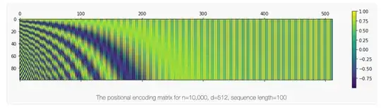

If you look at how much each scalar in the the positional embedding vector changes as a function of position... you'll find that many of the scalars barely change at all. You can visualize this with any positional embedding plot, where the x axis is usually the [512] length of the vector, and the y axis is the position of the token.
For example, this image is from Jay Alammar's well regarded "The Illustrated Transformer"
Let's try to do this mathematically as well. The implementation of PE's that Jay references is at this Google GitHub repo:
https://github.com/tensorflow/tensor2tensor/tree/23bd23b9830059fbc349381b70d9429b5c40a139
Running the function on a PE/WE of length 512 and max sentence length of 128, let's look at how much the final value in the vector actually changes from the first position, to the 64th position, to the final position. Answer: not much.
print(signal[0, 0, -1])
print(signal[0, 63, -1])
print(signal[0, 127, -1])
tf.Tensor(1.0, shape=(), dtype=float32) tf.Tensor(0.99998015, shape=(), dtype=float32) tf.Tensor(0.99991935, shape=(), dtype=float32)
Ditto for a value 16 steps away from the final location:
print(signal[0, 0, -16])
print(signal[0, 63, -16])
print(signal[0, 127, -16])
tf.Tensor(1.0, shape=(), dtype=float32) tf.Tensor(0.9984067, shape=(), dtype=float32) tf.Tensor(0.9935305, shape=(), dtype=float32)
I saw elsewhere that BERT's WEs are typically roughly the range of [-2, 2], so adding a 0.007 delta from the PE would not move the WE very much at the -16th position.
So what I think is probably happening is that only ~256 of the PE vector's values are actually moving around as a function of the position... the rest are ~constant. Then the learned WE (Transformers don't use prelearned WE like word2vec or glove), figures out to only use the other ~256 elements. So really... it's conceptually a concat.
