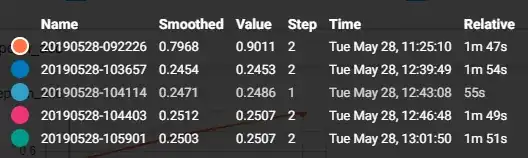

I have a problem where my results variation is very big. The first time I ran the model today I got around 90% accuracy. But the runs after that were around 25% which is as good as guessing since I have four classes.
The results in Tensorboard

Am I doing something completely wrong with the model? I do have quite a small dataset, just 1640 images. But why do some runs perform so good then?
I commented previously, now some idea as an answer:
1) I think that the validation data may include "lucky shots" which match the trained patterns well in some cases. Also a small validation set can be a problem. As far as I know, validation data is the last X% of the data (in Keras). You can set shuffle=True to mix validation data or False to not mix it (as I understand). I would try this. https://github.com/keras-team/keras/issues/597
2) An option to get a good idea of how the model performs is cross validation. If you can afford it, train 3 or 5 or 10 models with different validation data and have a look at the average accuracy. Should give you also an idea of how volatile the results are.
3) You have a small sample. Thus, adding more validation data can be a problem. However, I would also try with 20%.
4) Since you have a small sample, the NN might have trouble getting all the relevant features. Instead of training a convnet from scratch, you can use a pretrained model. This has already learned a lot of features. Given a small sample, this could be THE way to go. Note that there are a number of different pretrained models which you can try. https://keras.io/applications/
5) Get more data (if possible).
