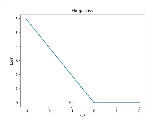

Plot
This Hinge name comes from the plot:
(the values and slope might differ)
Here the $x-axis$ is the actual class's score and the $y-axis$ is the Loss value. As seen in the plot, we set a sample $s_j$ for a class, for this $s_j$, if the real class's score is something more than 0, then since $s_j - s_(y_i) + 1$ is negative, the loss value would be 0 and so on.
