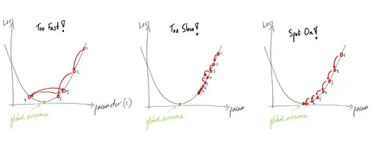

Imagine we have a 2d loss surface; a loss curve as in the figures below. In order to reach the global minimum (the lowest point on the curve), you would need to make steady progress towards the minimum and also reduce the size of the steps that you take on the way, as to not overshoot the minimum (left figure). If you slow down too fast, you never quite reach the minimum (middle figure). If you get it just right, you make it to the global minimum (right figure). The size of those jumps is controlled by the learning rate, which is multiplied with the loss in each iteration of back-propagation.
gradient descent variants
For this theoretical achievement, the theory requires the loss curve to be convex - meaning it has a shape similar to those in the figures. Here is a recent paper that explores this in more detail. The title says it all: Gradient Descent Finds Global Minima of Deep Neural Networks
There are methods to increase your chances of success, usually involving using a dynamic learning rate, which is adjusted to the rate at which the model learns i.e. how well it improves on a validation data set whilst learning from the training set. As the figure on the right above shows, it is desirable to reduce the learning rate as the loss curve flattens out.
In reality, the "loss surface" on which we are searching for are not 2-dimensional, but have much higher orders e.g. 200. Things such as random initialisation of your model could make the difference between which one you finally land in.
This is perhaps why using ensemble methods (groups of models) generally performs better than a single model. It explores the loss landscape more thoroughly and increases the odds of finding better minima.

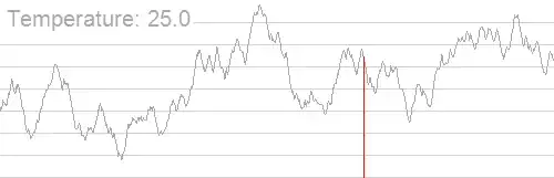

  • using simulated annealing, which is a fancy way of saying that we perform larger jumps to different areas on the loss curve, exploring more of it and not limiting ourselves to local minima. Here is a small graphic (from Wikipedia) that shows it in action:
Simulated annealing
Here is a superb blog post about these optimisers and simulated annealing as another way to "jump" out of local minima.
