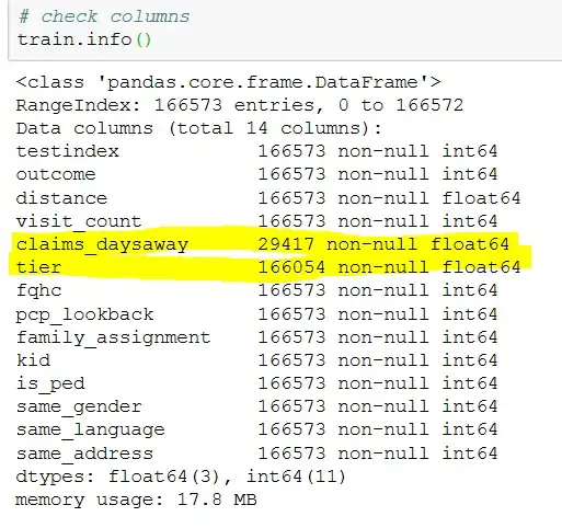

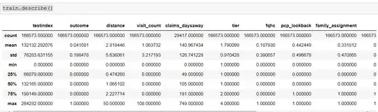

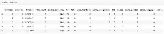

I need some suggestions to improve my model accuracy.
The training data shape is : (166573, 14)
train data
It has all int and float columns. I have dropped claims_daysaway column as most of values are NaN and replaced Nan value with mean for tier column.
X_train = train.drop(['outcome','testindex','claims_daysaway'], axis=1)
y_train = train['outcome']
As the values were on different scale, I have used StandScaler() to standardize values.
This dataset is highly imbalanced.
