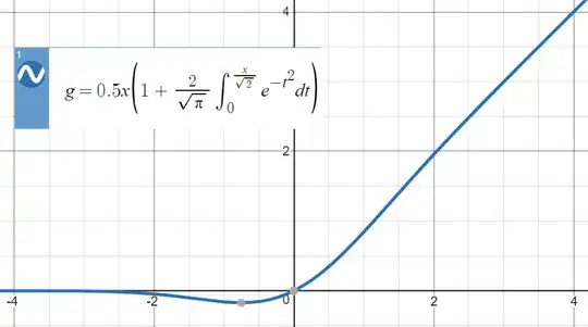

GELU function
We can expand the cumulative distribution of $\mathcal{N}(0, 1)$, i.e. $\Phi(x)$, as follows: $$\text{GELU}(x):=x{\Bbb P}(X \le x)=x\Phi(x)=0.5x\left(1+\text{erf}\left(\frac{x}{\sqrt{2}}\right)\right)$$
Note that this is a definition, not an equation (or a relation). Authors have provided some justifications for this proposal, e.g. a stochastic analogy, however mathematically, this is just a definition.
Here is the plot of GELU:

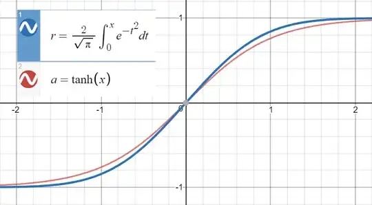

Tanh approximation
For these type of numerical approximations, the key idea is to find a similar function (primarily based on experience), parameterize it, and then fit it to a set of points from the original function.
Knowing that $\text{erf}(x)$ is very close to $\text{tanh}(x)$
and first derivative of $\text{erf}(\frac{x}{\sqrt{2}})$ coincides with that of $\text{tanh}(\sqrt{\frac{2}{\pi}}x)$ at $x=0$, which is $\sqrt{\frac{2}{\pi}}$, we proceed to fit $$\text{tanh}\left(\sqrt{\frac{2}{\pi}}(x+ax^2+bx^3+cx^4+dx^5)\right)$$ (or with more terms) to a set of points $\left(x_i, \text{erf}\left(\frac{x_i}{\sqrt{2}}\right)\right)$.

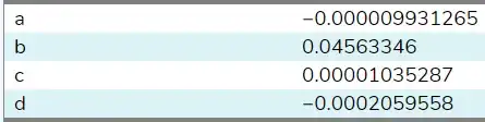

I have fitted this function to 20 samples between $(-1.5, 1.5)$ (using this site), and here are the coefficients:
By setting $a=c=d=0$, $b$ was estimated to be $0.04495641$. With more samples from a wider range (that site only allowed 20), coefficient $b$ will be closer to paper's $0.044715$. Finally we get
$\text{GELU}(x)=x\Phi(x)=0.5x\left(1+\text{erf}\left(\frac{x}{\sqrt{2}}\right)\right)\simeq 0.5x\left(1+\text{tanh}\left(\sqrt{\frac{2}{\pi}}(x+0.044715x^3)\right)\right)$
with mean squared error $\sim 10^{-8}$ for $x \in [-10, 10]$.

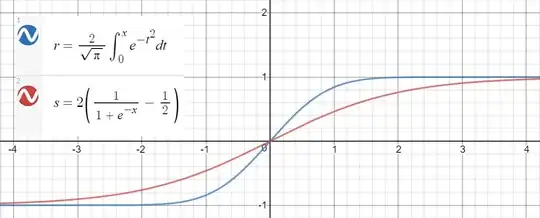

Sigmoid approximation
A similar relationship holds between $\text{erf}(x)$ and $2\left(\sigma(x)-\frac{1}{2}\right)$ (sigmoid), which is proposed in the paper as another approximation, with mean squared error $\sim 10^{-4}$ for $x \in [-10, 10]$.
