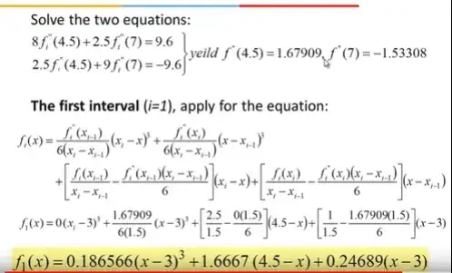

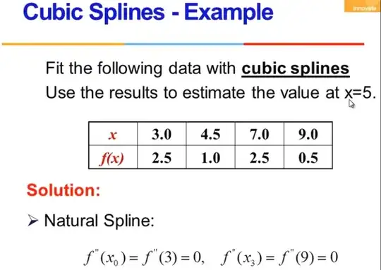

Continuation of Spline interpolation - why cube with 2nd derivative as following Cubic Spline Interpolation in youtube. The example in the youtube is below.

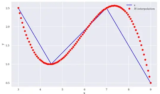

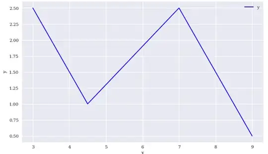

x = np.array([3.0, 4.5, 7.0, 9.0])
y = np.array([2.5, 1.0, 2.5, 0.5])
create_plot([x], [y], ['b'], ['y'], ['x', 'y'])
import scipy.interpolate as spi
interpolation = spi.splrep(x, y, k=3)
IX = np.linspace(3, 9, 100)
IY = spi.splev(IX, interpolation)
create_plot(
    [x, IX],
    [y, IY],
    ['b', 'ro'],
    ['x', 'IY:interpolation'],
    ['x', 'y']

The solution of the first interval is (0.186566, 1.6667, 0.24689), hence I thought these values would be in the 2nd element, but not. How the solution values would relate to the return values?
