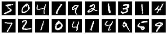

print('Predict the classes: ')
prediction = model.predict_classes(x_test_reshaped[10:20])
show_imgs(x_test[10:20])
print('Predicted classes: ', prediction)
Predicted classes: [0 6 9 0 1 5 9 7 3 4]
The code to print the MNIST database nicely
