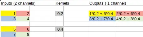

I'm confused by the concept of equating a 1x1 convolution with a fully connected layer. Take the following simple example of a 1x1 convolution of 2 input channels each of size 2x2, and a single output channel.
The only way I can relate this to fully connected layers is to say that there are 4 fully connected layers, one for each location in the input feature map (inputs and outputs colour coded).

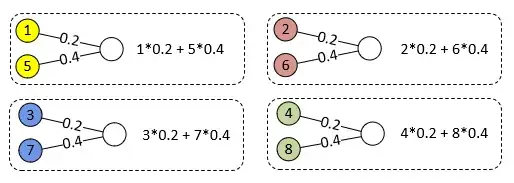

The interpretation that the 1d convolution given in the OP can be duplicated with four separate fully-connected layers is correct (see diagram). Also, in at least some implementations, kernel weights used during a 1x1 convolution can be made trainable the same way weights in a fully-connected layer can be made trainable. These points made, every fully-connected layer can not be mathematically duplicated by an equivalent 1x1 convolution. This is based on the definition that 1x1 convolution performs a "column-wise dot product" such that every pixel column in a multi-layer feature map is reduced to a single number (pixel). A fully-connected layer intermixes weights differently from the way weights are intermixed when performing a 1x1 convolution. In summary, fully connected layers and 1x1 convolutions each have their own use cases -- some overlap among these use cases exists; however, the two are not intended to be mathematically equivalent in a general sense.
Four separate "dense layers" equivalent to the 1x1 convolution in OP
