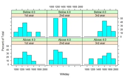

How can I plot the histogram below, using ggplot (R) and/or matplotlib (Python)?
In base plot I use:
histogram(~ Wrkday | Year+Avg, data=Data, layout=c(3,2))
graph by base plot
The data I work on:
Code in R:
Input <- ("
Year       Student  Wrkday
      '1st year'  a        1200
      '1st year'  b        1400
      '1st year'  c        1350
      '1st year'  d         950
      '1st year'  e        1400
      '1st year'  f        1150
      '1st year'  g        1300
      '1st year'  h        1325
      '1st year'  i        1425
      '1st year'  j        1500
      '1st year'  k        1250
      '1st year'  l        1150
      '1st year'  m         950
      '1st year'  n        1150
      '1st year'  o        1600
      '1st year'  p        1300
      '1st year'  q        1050
      '1st year'  r        1300
      '1st year'  s        1700
      '1st year'  t        1300
      '2nd year'  u        1100
      '2nd year'  v        1200
      '2nd year'  w        1250
      '2nd year'  x        1050
      '2nd year'  y        1200
      '2nd year'  z        1250
      '2nd year'  aa       1350
      '2nd year'  ab       1350
      '2nd year'  ac       1325
      '2nd year'  ad       1525
      '2nd year'  ae       1225
      '2nd year'  af       1125
      '2nd year'  ag       1000
      '2nd year'  ah       1125
      '2nd year'  ai       1400
      '2nd year'  aj       1200
      '2nd year'  ak       1150
      '2nd year'  al       1400
      '2nd year'  am       1500
      '2nd year'  an       1200
      '3rd year'  u        1600
      '3rd year'  v        1700
      '3rd year'  w        1450
      '3rd year'  x        1650
      '3rd year'  y        1800
      '3rd year'  z        1550
      '3rd year'  aa       1950
      '3rd year'  ab       1750
      '3rd year'  ac       1925
      '3rd year'  ad       1825
      '3rd year'  ae       1625
      '3rd year'  af       1525
      '3rd year'  ag       1800
      '3rd year'  ah       1725
      '3rd year'  ai       1200
      '3rd year'  aj       1600
      '3rd year'  ak       1950
      '3rd year'  al       1100
      '3rd year'  am       1400
      '3rd year'  an       1600

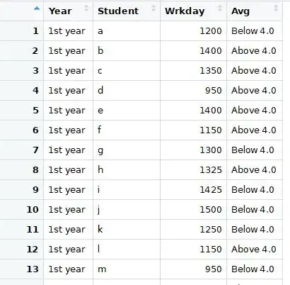

Data <- read.table(textConnection(Input),header=TRUE)
los<-rbinom(nrow(Data), size = 1, prob=0.7)
Data$Avg<-ifelse(los==1,"Above 4.0","Below 4.0")
I would like to plot linear model in each box instead of histogram.

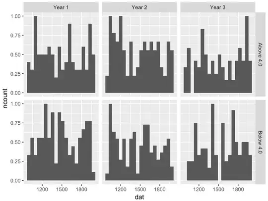

I don't know what you mean by "with linear model" in the title, but here's code that generates a toy dataset and replicates your plot.
library(tidyverse)
x<-crossing(year=paste("Year", 1:3), avg=c("Above 4.0", "Below 4.0"))
x$dat<-replicate(6, tibble(wrkday=runif(100, 1000, 2000)))
x %>%
  unnest(dat) %>%
  ggplot(aes(dat)) +
  geom_histogram(aes(y=..ncount..), bins=20) +
  facet_grid(avg~year)

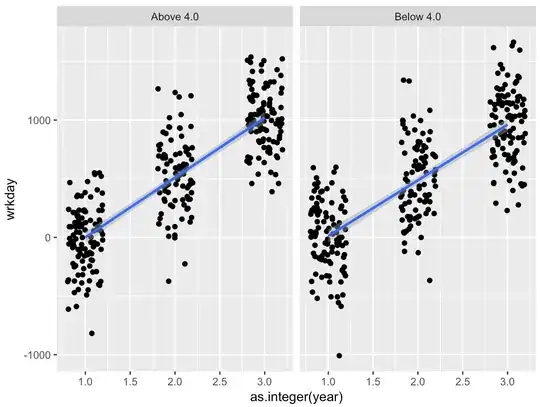

EDIT:
Given your comment I think I understand what you mean by "with linear model." You want to see how wrkday varies as a function of year, faceted by avg. Here's some code:
library(tidyverse)
x<-tibble(year=sample(factor(paste("Year", 1:3)), 600, replace=T),
          avg=sample(c("Above 4.0", "Below 4.0"), 600, replace=T)) %>%
  mutate(wrkday=rnorm(600, mean=1000*(as.integer(year)-1)/2, sd=300))
ggplot(x, aes(x=as.integer(year), y=wrkday)) +
  geom_jitter(width=0.2) +
  geom_smooth(method="lm") +
  facet_wrap(~avg)
