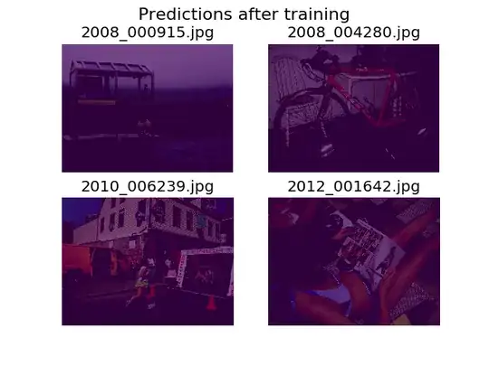

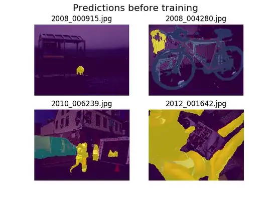

I decided to plot predictions on the same set of random images before and after training, and found that the model is encouraged to say everything is just background (that's the 1st class in Pascal VOC2012).
I'm quite new to deep learning and would need help to figure out where this could come from.

Your model is overfitting. Each epoch only has 5 images. The model is "memorizing" the answer for each image.
In order to minimize the chance of overfitting, increase the number of images. There should be several thousand example images for each category of object.
