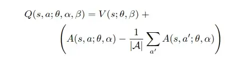

enter image description here could anyone who can help me if we decompose them and combine back them into a single Q, what the network can learn? from my perspective,the V means the total reward when the agent follow the current policy;the Q means if we give a specific action then follow the current policy what the total reward; and if we get the optimal policy,the V will equal to Q;so we should learn to make the A reach zero;just like the answer :Dueling DQN - can't understand its mechanism

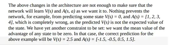

but in that paper,i cannot understand what is the matter if we cannot identify the sense that given Q we cannot recover V and A uniqueluy. enter image description here
and it will get this blow finally:
and as well as this: enter image description here

Dueling DQN
The Dueling DQN can solve the overoptimistic problem as well
$$ Q(s,a) = V(s) - A(s,a)$$
The intuition behind the advantage is how much you're action value differs from the state value.
For example, if you have a state in which you have two actions, the first brings you returns of + 100 and the second is + 1. In this case, both action values are positive because you get positive reward. The advantages on the contrary are different. If you take this suboptimal action, then you get the action value of (+ 1) minus the state value of (+ 100), which is -99. Basically, it tells you that you have just lost 99 potential units of rewards in this case.
To predict advantages, we have to constrain them. In case of $V^*$, the maximum possible advantage value is zero because you can never get action value which is larger than maximum over all possible action values from the state.
So you you train two halves together and then just add them up to get your action values.
