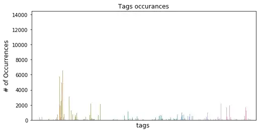

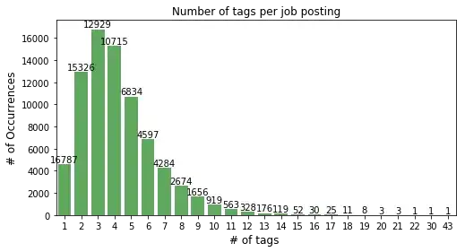

I have a dataset with job titles and descriptions. The task is to predict tags for job by job title and description.
There are several tags for each job posting. Therefore, the number of labels for the model will be measured in tens of thousands.
Number of job postings = 78042

The ratio of number of examples to number of classes is not large. There are few classes which have high number of occurrences (from the second graph) and the distribution seems to be following power law.
