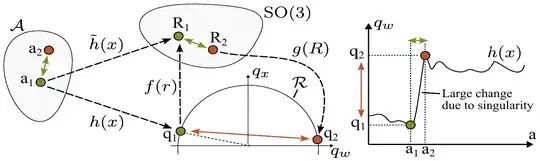

Every rotation representation with four or less parameters (e.g. Euler angles, Quaternions, Axis-angle vectors, Exponential coordinates) inevitably has singular points in its map to SO(3) aka the space of 3D rotation matrices. Consider the figure below, here we map features $a$ to quaternions $q$. Quaternions double cover SO(3) that is, $q$ and $-q$ correspond to the same rotation matrix. In turn, large distances in quaternion space can correspond to small distances between two rotation matrices $R_1$ and $R_2$. As a consequence, if your target function has as outputs quaternions then there exist points in feature space where the output may jump through the full width of quaternion space. Learning these discontinuities is difficult.
Quaternion example

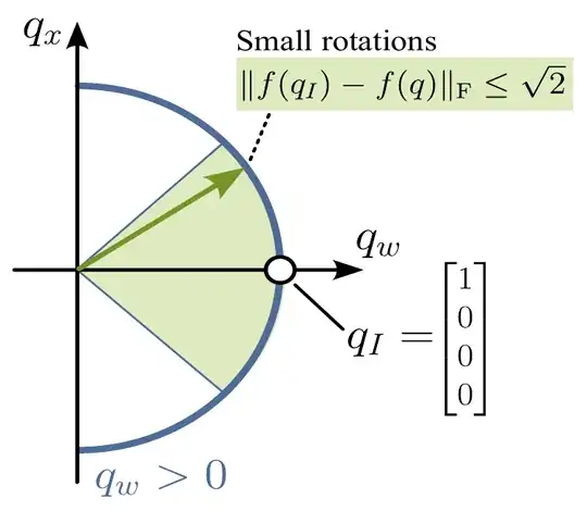

If your 3D rotations are small, that is $\|I_3 - R\|_{\mathbb{F}} \leq \sqrt{2}$, then mapping the rotation matrices to quaternion space does not introduce jumps into the target function.

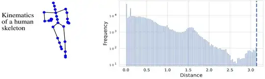

For example, consider the MoCap human skeleton data. Most of the 3D rotations in this data set have a small distance to the "unit rotation" $I_3$. In this case, learning with quaternions in the output of your model is fine.
