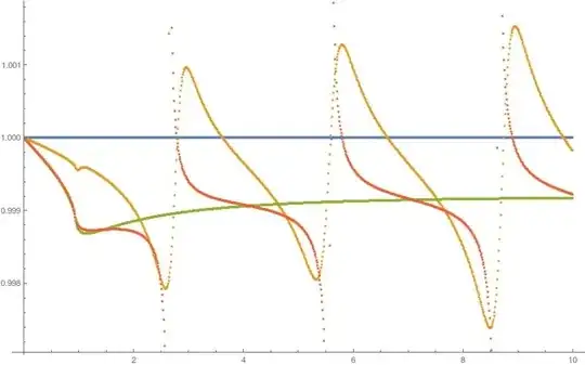

I have 20 1D datasets with 400 entries each. In the picture they are denoted by different colors. enter image description here
As you can see, they are also pretty continuous. However, for each index i the datasets have been re-ordered by magnitude, i.e. instead of nice continuous lines, the color now jumps at every intersection of each two datasets.
Is there a way to bring the the datasets to their original order? I.e. cluster the data into 20 continuous lines? This could be easily done by eye.

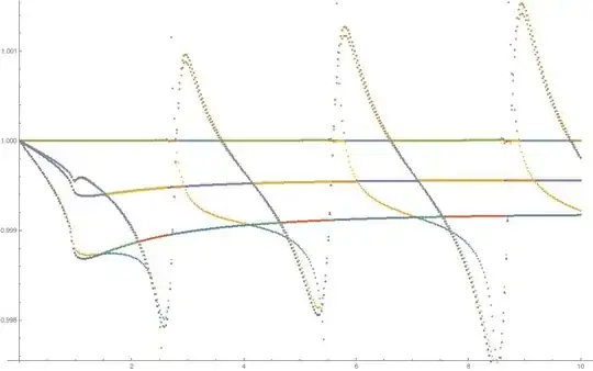

I ended up soling this by cutting the datasets into segments and then gluing them together. Here are some of the disentangled datasets:
First I cut all the datasetes into continuous segments by identifying the discontinuities (I looked at peaks of the second derivative). I then sowed the segments together based on which segment is the closest to the 2nd order interpolation from the neighboring segment.
There were some special cases that I had to deal with - for example actual divergences in the signal. I dealt with these by identifying segments that cannot be continuously sowed into any other segments (these are the ones going to +-infinity) and gluing them to other segment returning from +- infinity.
