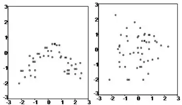

  1. There is a linear relationship between the dependent variables and the regressors (right figure below), meaning the model you are creating actually fits the data. enter image description here

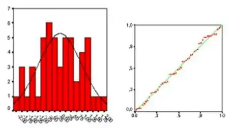

  2. The errors or residuals of the data are normally distributed and independent from each other. enter image description here

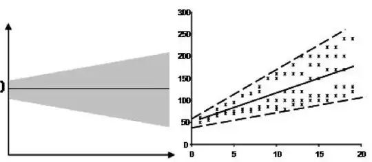

  3. Homoscedasticity. This means the variance around the regression line is the same for all values of the predictor variable. enter image description here
