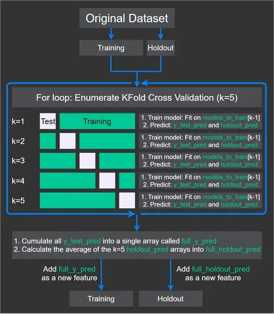

Yes, you can definitely use first base model predictions as inputs to meta learning. It can improve models and has been used a lot in competitive platforms.
This technique is known as stacking technique and is prone to over fitting. If you want to do stacking for your models the i would suggest to use out of sample cross validation score and see the performance.
You should try to follow this nelow appraoch it helps in limiting overfitting (read overfitting can still happend but chances are reduced with good design) : enter image description here
https://developer.ibm.com/articles/stack-machine-learning-models-get-better-results/
