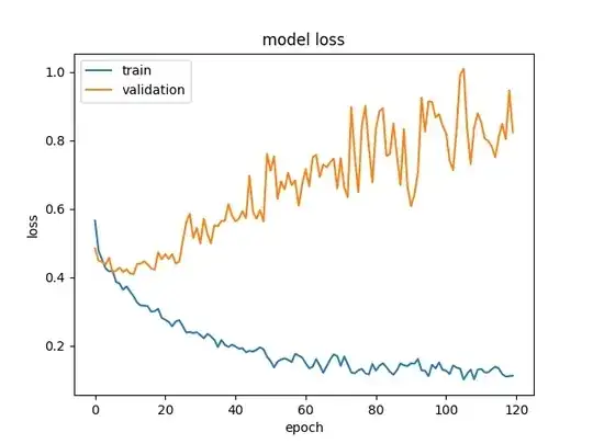

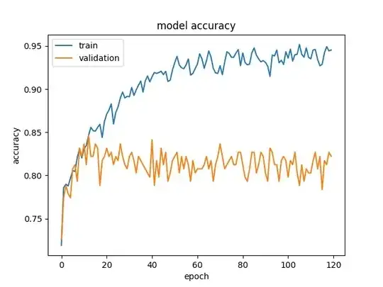

I'm a new programmer and this is my first ever neural network for real world application.
Here is the deal, I'm using a top-less pre-trained VGG-16 with some dense layers on top of it.(for image classification problem)
But no matter what hyper parameters I change I always get plots similar to these.
So my question is at what loss (val_loss) can we consider the model trained?

And if someone could explain how high validation loss (even if validation accuracy is high) could impact the model?

Your model is indeed overfitting. There can be a lot of reasons why it could be happening - How many images are you training with?, Aren't you using Regularization, data augmentation using random crops or flips, Dropout to prevent overfitting?
We can generally stop training when Validation loss doesn't decrease anymore. This is generally done by defining a variable eg: n = 5 and checking if the validation loss has decreased after running n epochs. If you're solving a well-known problem(MNIST, Fashion-MNIST, CIFAR-10, etc), you can check the best score/loss achievable by the model and tweak your model(add or remove layers, prevent overfitting, etc) to achieve the score.
Validation loss measures how generalizable your model is to unseen data. If your training loss and validation loss don't improve during training, then you are underfitting. If you're training loss is low but your validation loss is stagnant or increasing then you're overfitting, which means that your model is learning unwanted noise or patterns which help it learn or memorize training data but are not generalizable on an unseen validation set.
Here is a link explaining data preprocessing, augmentation, transfer learning using pretrained net.
Indeed, high validation loss can badly effect the accuracy of your model with test data. In this case, absolutely overfitting is happening which in machine learning literature is addressed as high variance problem, too. Overfitting limits the generalization of your model.
