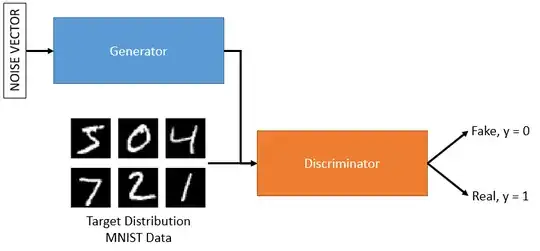

There is really nothing special about the backpropagation algorithm in a generative adversarial network (GAN). It is the same as that of a convolutional neural network (CNN), as CNNs are usually what the generator and discriminator of the GAN are made of. I will assume the MNIST toy example for the explanation and I will provide code to get a GAN working below.
The GAN
A GAN is composed of a discriminator and a generator. Each of these are held constant while training the other. We will thus alternate between training the discriminator and the generator. This is done separately. Training the discriminator is much easier so lets look at that, then we will look at training the generator as you asked in your question.

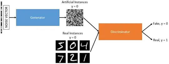

The discriminator has two output nodes and is used to distinguish real instances from artificial instances. To train the discriminator we will generate $m$ instances using forward passes from the generator, these are the artificial instances, their label will be $y = 0$. To generate these we simply pass a noise vector as the input to the model. We will also use $m$ instances from the real data these will have labels $y = 1$.
We can then see that the discriminator is trained exactly the same way as a basic classification CNN with 2 output nodes. I will describe the training process of a CNN below.

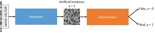

Training the generator
When we train the generator we will keep the discriminator fixed, this is necessary as to not saturate our parameters and make the discriminator too strong to ever beat. So what we essentially have is a CNN (the generator) connected to another CNN (the discriminator). The connecting nodes between these two models is going to be output which will generate the desired images once trained. Do note that the generator wants the instances it will produce in this case to be classified by the discriminator as being from the real distribution, so they will have labels $y = 1$.
All together this is just a CNN and the backpropagation will be computed in the exact same way. First we pass through a noise vector, it goes through the generator, some random image gets produced at its output, that then goes through the discriminator and gets classified as $artificial$. But, we are expecting the discriminator to be fooled in this case, so this is an error, it should have been labeled as $real$. We then use backpropagation to get the error contribution of each model parameter. We will then use gradient descent to update all the parameters associated with the generator.
