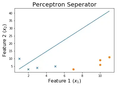

After 10 epochs

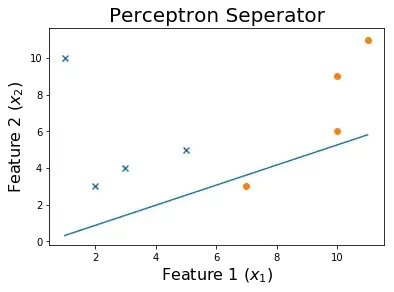

After 20 epochs

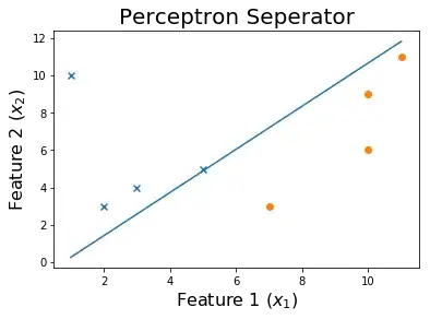

After 50 epochs

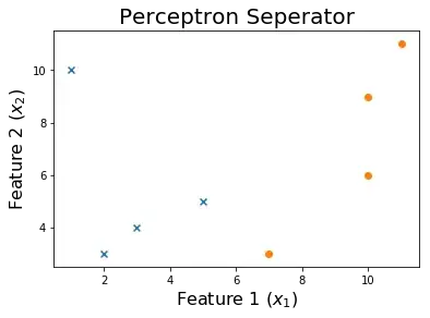

After 100 epochs
And finally,

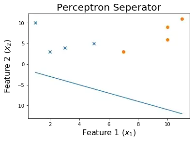

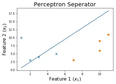

Let's plot the decision boundary
x1 = np.linspace(np.amin(x[:,1]),np.amax(x[:,2]),2)
x2 = np.zeros((2,))
for ix, i in enumerate(x1):
    x2[ix] = (-w[0] - w[1]*i) / w[2]
plt.scatter(x[y>0][:,1], x[y>0][:,2], marker = 'x')
plt.scatter(x[y<0][:,1], x[y<0][:,2], marker = 'o')
plt.plot(x1,x2)
plt.title('Perceptron Seperator', fontsize=20)
plt.xlabel('Feature 1 ($x_1$)', fontsize=16)
plt.ylabel('Feature 2 ($x_2$)', fontsize=16)
plt.show()

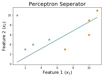

To see the training process you can print the weights as they changed through the epochs.
for ix, w in enumerate(all_weights):
    if ix % 10 == 0:
        print('Weights:', w)
        x2 = np.zeros((2,))
        print('$0 = ' + str(-w[0]) + ' - ' + str(w[1]) + 'x_1'+ ' - ' + str(w[2]) + 'x_2$')
        plt.plot(x1,x2)
        plt.show()
