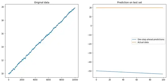

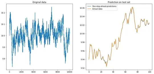

If I set drift=0, displacement=0, everything works fine: enter image description here
Then I set drift=0, displacement=10 and things went pear-shaped (notice the different scale on the y-axis): enter image description here

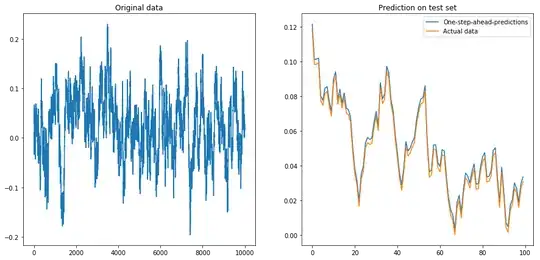

This is not terribly surprising: LSTMs should be fed with normalized data! So I normalized the data by rescaling it to the interval $[-1, 1]$. Phew, things are fine again: enter image description here

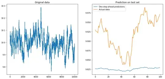

Then I set drift=0.00001, displacement=10, normalized the data again and ran the algorithm on it. This does not look good: enter image description here

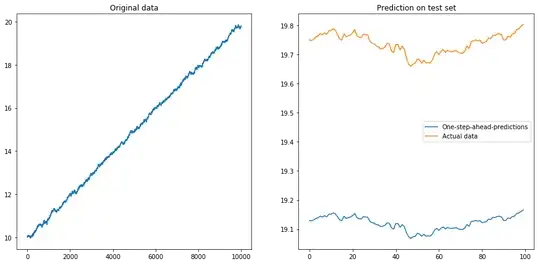

Apparently the LSTM cannot deal with a drift. What to do? (Yes, in this toy example I could simply subtract the drift; but for real-world time series, this is much harder). Maybe I could run my LSTM on the difference $X_{t} - X_{t-1}$ instead of the original time series $X_t$. This will remove any constant drift from the time series. But running the LSTM on the differenced time series does not work at all: enter image description here
My question: Why does my algorithm break down when I use it on the differenced time series? What is a good way to deal with drifts in time series?

Looking again at your autocorrelated process:
    def my_process(n, p, drift=0, displacement=0):
        x = np.zeros(n)
        for i in range(1, n):
            x[i] = drift * i + p * x[i-1] + (1-p) * np.random.randn()
    return x + displacement
It looks like things are breaking down when the value of displacement is high. This makes sense, as you say, because LSTMs need normalized data.
The drift parameter is a bit different. When a small amount of drift is included, since p is large, the amount of drift is similar to the amount of random noise being added via np.random.randn().
In the plots for drift=0.00001, displacement=10, it looks like the predictions would be fine except for the y-shift. Because of this, I think the root of the problem is still in the displacement parameter, not the drift parameter. Differencing, as has been done, will not help with the displacement parameter; instead, it corrects for drift.
I can't tell from your code, but it looks like perhaps the displacement was not accounted for in model.predict. That's my best guess.
StatsSorceress
  • 2,021
  • 16
  • 30
When you choose x_min and x_max, you are choosing it from 1:threshold alone. Since your series is monotonically increasing (well almost..), the testing values are all values > 1. This, the LSTM model has never seen during training at all.
Is that why you are seeing what you are seeing?
Can you try the same with x_min and x_max coming from the whole dataset instead?
