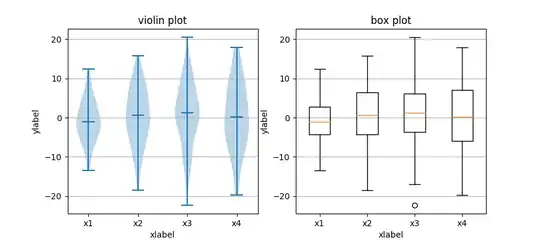

In most papers people use boxplots to visualize a certain distribution, yet violinplots are able to give more information. Violinplots are made by performing a kernel density estimation on your distribution.
Are there objective arguments to use one over the other? Or maybe there are specific situations in which one would prefer one over the other?
An example of both can be found here: enter image description here

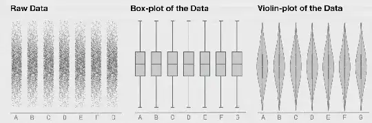

I am a big fan of violin plots. Although both aim for the same goal (visualizing distributions and key figures of some data), box plots have their limitations. Have a look into following animation (taken from here):
Box plots are not able to capture the change in the raw data, while violin plots do so.

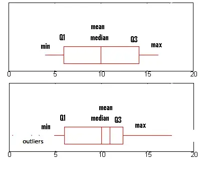

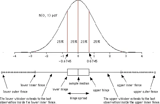

Well, that is not true that Boxplot only gives hard stops! Violin plots are rather contemporary version of Boxplots I would say, and easy for the eyes to see the distribution of data. Boxplots also can reveal how data is distributed. For example, here you see a Boxplot of a normally distributed data that is symmetrical with the mean and median in the center (top), as well as a non-normal data (bottom). The source is here.
More details of how to interpret a Boxplot in terms of a normal distribution, look here:
