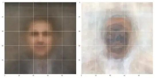

Taking the mean (left) and standard deviation (right) of the batch, we get the following: mean (left) and standard deviation (right)

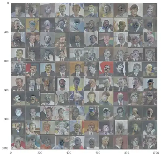

Our centered data resembles a face, but more importantly our standard deviation image shows great variance along the borders and everywhere except the face. From our z-score formula, we can predict that the standardized values near the border and irrelevant areas will be relatively squashed more than values around the face. The resultant normalization appears as such: enter image description here
