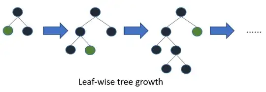

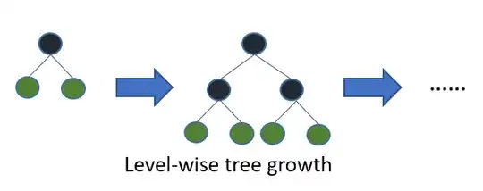

I am confused by the description of LightGBM regarding the way the tree is expanded.
They state:
Most decision tree learning algorithms grow tree by level (depth)-wise, like the following image:
Questions 1: Which "most" algorithms are implemented this way? As far as I know C4.5 and CART use DFS. XGBoost uses BFS. Which other algorithms or packages use BFS for decision trees?
Issue 2:
LightGBM states:
LightGBM grows tree by leaf-wise (best-first).It will choose the leaf with max delta loss to grow. When growing same leaf, leaf-wise algorithm can reduce more loss than level-wise algorithm.
Question 2: Is it correct to say that level-wise growth trees will have equal depth for all leaves?
Questions 3: If Question 2 is not correct, then the trees from level-wise and leaf-wise growth will look the same at the end of the traversal (without pruning etc). Is it a correct statement?
Questions 4: If question 3 is correct, how can "leaf-wise algorithm can reduce more loss than level-wise algorithm"? Does it have to do with the post-pruning algorithm?

If you grow the full tree, best-first (leaf-wise) and depth-first (level-wise) will result in the same tree. The difference is in the order in which the tree is expanded. Since we don't normally grow trees to their full depth, order matters: application of early stopping criteria and pruning methods can result in very different trees. Because leaf-wise chooses splits based on their contribution to the global loss and not just the loss along a particular branch, it often (not always) will learn lower-error trees "faster" than level-wise. I.e. for a given number of leaves, leaf-wise will probably out-perform level-wise. As you add more nodes, without stopping or pruning they will converge to the same performance because they will literally build the same tree eventually.
