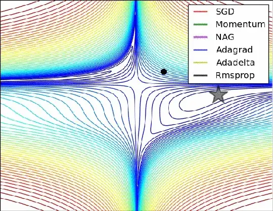

You can actually see this occurring for RMSProp in a comparison of different optimisers (RMSProp is the black line - watch the very last steps just as it reaches the target):
