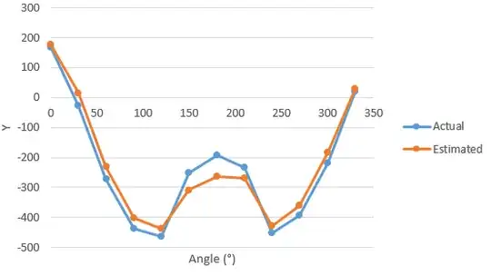

The output we're trying to estimate consists of the shape of 432 periodic functions (i.e. value of 432 different functions along the circumference of a circle). We know that the output is uniquely determined by the 28 input values; there's no noise.
For example, here is one of these periodic functions. For this example, it's only sampled with 12 points (though in production we will be sampling it more finely, perhaps 36 points around a circle).

As illustrated above, this works okay (even before optimizing hyperparameters).

Rather than trying to predict each value explicitly, you could pick a parametric function that you think might be expressive enough to describe your target function (for example, a polynomial of order 6), and get your network to learn the parameters of that polynomial that give you a minimum loss. This is basically polynomial regression. Since your function is periodic you might use a more cycle-based basis set, like linear combinations of sine waves.
For example:
1) Input data to the network 2) output a set of values that you treat as parameters to your function 3) for each target point, compare it to the predicted value from your function 4) calculate a loss (like mean squared error) based on the difference between the function predictions and the targets.
Using a function will (1) restrict the space of possible outputs, and (2) make nearby outputs be self-similar.
