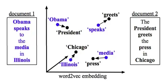

Word Mover’s Distance (WMD) is an algorithm for finding the distance between sentences. WMD is based on word embeddings (e.g., word2vec) which encode the semantic meaning of words into dense vectors.
The WMD distance measures the dissimilarity between two text documents as the minimum amount of distance that the embedded words of one document need to "travel" to reach the embedded words of another document.
For example:
enter image description here Source: "From Word Embeddings To Document Distances" Paper
The gensim package has a WMD implementation.
For your problem, you would compare the inputted sentence to all other sentences and return the sentence that has lowest WMD.
