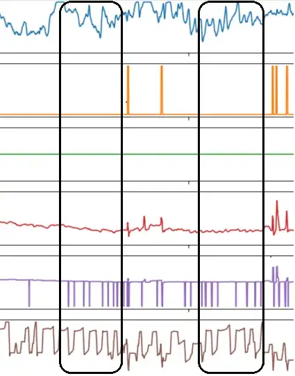

Experts in my field are capable of predicting the likelyhood an event (binary spike in yellow) 30 minutes before it occurs. Frequency here is 1 sec, this view represents a few hours worth of data, i have circled in black where "malicious" pattern should be. Interactions between the dimensions exist, therefore dimensions cannot be studied individually (or can they?)
I'm trying to build a supervised ML model using Scikit Learn which learns a normal rythm, and detects when symptoms might lead to a spike. I am lost for which direction to take. I have tried Anomaly detection, but it only works for on the spot detection, not prior.
How could I detect "malicious" patterns prior to those events (taking them as target variables) ?
I welcome any advice on which algorithms or data processing pipeline might help, thank you :)

This is a fun problem. This is a time series and from this time series you want to identify the trigger of a certain event. So it is a binary classification problem. Based on the information from the specified window will a spike occur? Yes or No.
The first step is to set up your database. What you will have is a set of instances (which can have some overlap but to avoid bias it is best for them to be independently drawn) and then for each instance a human needs to label if there was a spike or if there was not a spike.
Then you need to identify the time window you want to use for your time series analysis. You have done this and decided 30 minutes is a good start.
Now, you have 6 waveforms in a 30 minute window from which you can extract data to get information about your classification. You can use the raw data samples as your features, but this is WAY TOO many features and will lead to poor results. Thus you need some feature extraction, dimensionality reduction, techniques.
There are a million ways you can extract data from these waveforms. First, ask yourself, as a human what are the telltale signs that these other waveforms should have which would mean a spike would arise. For example, in seismic data, if you see agitation in a waveform from a neighboring town then you should expect to see agitation in your town soon.
In general, I like to extract all the basic statistics from my waveforms. Get the mean, standard deviation, fluctuation index, etc. Get whatever you think might help. Check how these statistics correlate with your labels. The more correlation the better they might be. Then there are some very good techniques for extracting time and frequency information from your time-series. Look into envelope mode decomposition and empirical mode decomposition. I have used empirical mode decomposition successfully on some time series data and obtained far better results than I expected.
Now even though you have your reduced feature space you can do better! You can apply some dimensionality reduction techniques such as PCA or LDA to get a lower dimensional space which may better represent your data. This might help, no guarantees.
Now you have a small dataset with instances that are a Frankenstein concoction which represents your 6 waveforms across the 30 minute window. Now you are all set to select your classifier. You will want a binary classification algorithm, luckily that is the most common. There are many to choose from. How to choose?

You need to do feature extraction or feature engineering to create variables in your training data that "catch" those patterns you boxed in and then have a target variable saying "malice found" or "malice found not found"
Take a really simple example: predicting if it is going to rain. You could come up with a reasonably good predictor of rain in the next 30 minutes that checked every 30 minutes if 1. it suddenly got cloudy and 2. barometric pressure dropped.
