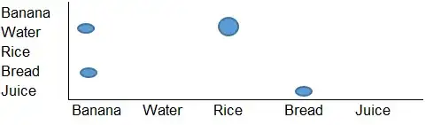

I want to create a visualization like the following:
example visualization
This is basically a grid chart but I need some tool (maybe Python or R) that can read the input structure and produce a chart like the above as output.

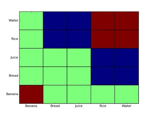

I think what you probably want is a discrete version of a heat map. For example, see below. The red colors indicate the most commonly purchased together, while green cells are never purchased together. heat map
This is actually fairly easy to put together with Pandas DataFrames and matplotlib.
import numpy as np
from pandas import DataFrame
import matplotlib
matplotlib.use('agg') # Write figure to disk instead of displaying (for Windows Subsystem for Linux)
# Get data into a data frame
data = [
  ['Banana', 'Water', 'Rice'],
  ['Rice', 'Water'],
  ['Bread', 'Banana', 'Juice'],
# Convert the input into a 2D dictionary
freqMap = {}
for line in data:
  for item in line:
    if not item in freqMap:
      freqMap[item] = {}
    for other_item in line:
      if not other_item in freqMap:
        freqMap[other_item] = {}
      freqMap[item][other_item] = freqMap[item].get(other_item, 0) + 1
      freqMap[other_item][item] = freqMap[other_item].get(item, 0) + 1
df = DataFrame(freqMap).T.fillna(0)
print (df)
# Create the plot
plt.pcolormesh(df, edgecolors='black')
plt.yticks(np.arange(0.5, len(df.index), 1), df.index)
plt.xticks(np.arange(0.5, len(df.columns), 1), df.columns)
plt.savefig('plot.png')

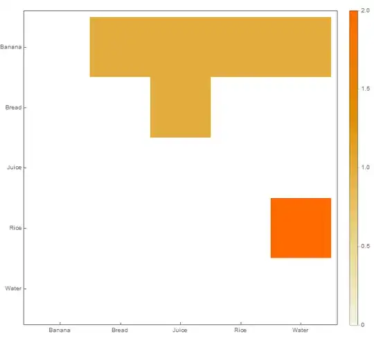

With Wolfram Language in Mathematica.
data = {{"Banana", "Water", "Rice"},
        {"Rice", "Water"},
        {"Bread", "Banana", "Juice"}};
Get pairwise counts.
counts = Sort /@ Flatten[Subsets[#, {2}] & /@ data, 1] // Tally
{{{"Banana", "Water"}, 1}, {{"Banana", "Rice"}, 1},
 {{"Rice", "Water"}, 2}, {{"Banana", "Bread"}, 1},
 {{"Bread", "Juice"}, 1}, {{"Banana", "Juice"}, 1}}
Get indices for named ticks.
indices = Thread[# -> Range[Length@#]] &@Sort@DeleteDuplicates@Flatten[data]
{"Banana" -> 1, "Bread" -> 2, "Juice" -> 3, "Rice" -> 4, "Water" -> 5}
Plot with MatrixPlot using SparseArray. Could also use ArrayPlot.
MatrixPlot[
 SparseArray[Rule @@@ counts /. indices, ConstantArray[Length@indices, 2]],
 FrameTicks -> With[{t = {#2, #1} & @@@ indices}, {{t, None}, {t, None}}],
 PlotLegends -> Automatic
Note that it is upper-triangular.

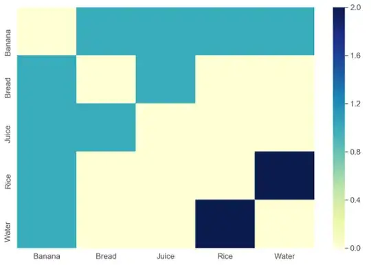

You can do this in python with the seaborn visualization library (built on top of matplotlib).
data = [
  ['Rice', 'Water'],
# Pull out combinations
from itertools import combinations
data_pairs = []
for d in data:
    data_pairs += [list(sorted(x)) + [1] for x in combinations(d, 2)]
    # Add reverse as well (this will mirror the heatmap)
    data_pairs += [list(sorted(x))[::-1] + [1] for x in combinations(d, 2)]
# Shape into dataframe
import pandas as pd
df = pd.DataFrame(data_pairs)
df_zeros = pd.DataFrame([list(x) + [0] for x in combinations(df[[0, 1]].values.flatten(), 2)])
df = pd.concat((df, df_zeros))
df = df.groupby([0, 1])[2].sum().reset_index().pivot(0, 1, 2).fillna(0)
import seaborn as sns
from matplotlib.pyplot import plt
sns.heatmap(df, cmap='YlGnBu')
plt.show()
The final dataframe df looks like this:
and the resulting visualization is:
