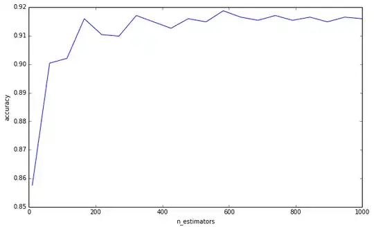

I did a simple experiment:
from sklearn.datasets import load_digits
from sklearn.ensemble import RandomForestClassifier
from sklearn.grid_search import GridSearchCV
import numpy as np
plt.ioff()
df = load_digits() X = df['data'] y = df['target']
cv = GridSearchCV( RandomForestClassifier(max_depth=4), {'n_estimators': np.linspace(10, 1000, 20, dtype=int)}, 'accuracy', n_jobs=-1, refit=False, cv=50, verbose=1) cv.fit(X, y)
scores = np.asarray([s[1] for s in cv.grid_scores_]) trees = np.asarray([s[0]['n_estimators'] for s in cv.grid_scores_]) o = np.argsort(trees) scores = scores[o] trees = trees[o] plt.clf() plt.plot(trees, scores) plt.xlabel('n_estimators') plt.ylabel('accuracy') plt.savefig('trees.png') plt.show()
performance

To answer your question, adding decision trees will always be beneficial to your ensemble. It will always make it more and more robust. But, of course, it is dubious whether the marginal 0.00000001 reduction in variance is worth the computational time.
