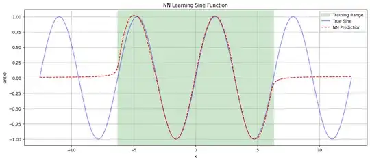

For example, a naive MLP does this:

Out-of-distribution is currently in research now.
A Neural Network aims to find a mathematical relation between the training and test data. However, the training data can be a subset of infinitely large data sets, so you can't guarantee that your NN will represent the mathematical relation you want.
To fix your issue, take as large a dataset as possible. But there could be oscillations in the loss because it's a sine wave and NN is somehow linear.
