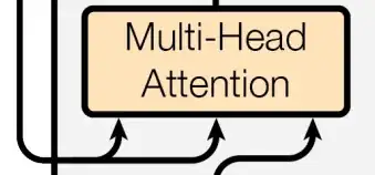

In the Vaswani 2017 paper introducing encoder-decoder transformers, the cross-attention step in the decoder is visualised as follows:
cross-attention
Because keys and values are always taken to be equal, this figure implies that the final encoder embeddings are used as keys and values, and the intermediate decoder embeddings are used as queries. Indeed, they write:
In "encoder-decoder attention" layers, the queries come from the previous decoder layer, and the memory keys and values come from the output of the encoder.
What this means is that we have $m$ decoder embeddings coming in from the previous decoder block, yet counterintuitively, we don't have $m$ linear combinations of those decoder embeddings coming out of the current decoder block, but $m$ linear combinations of the encoder embeddings.
