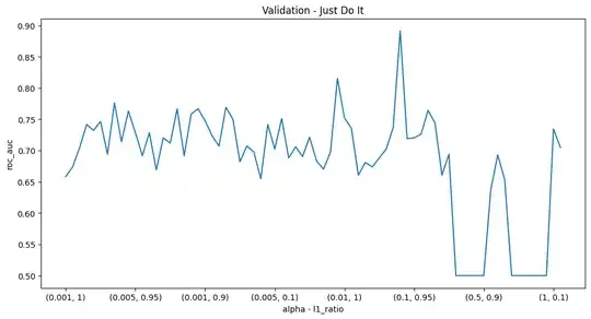

The problem is most of the time I run the loop to find the best model, I end up with a different set of hyperparameters/maximum score. For instance the graph of metric against hyperparameter pair can look like this: tuning 1
Then in another run it would look like this:
tuning 2 The best alpha, l1 ratio pair will usually be around 0.1,0.9 or 0.1,1. Then, when I pick the set of hyperparameters to construct the logistic regression model, there is often a different set of variables with nonzero coefficients in the model. Sometimes the model will have as low as 8 nonzero coefficients, and other times as high as 40. Changing max_iter in either step (I tried up to max_iter = 10 000 000)does not seem to solve the inconsistencies between runs. I suspect the problem is a lack of data (only 53 samples), but I'm not sure if there are any other causes.
