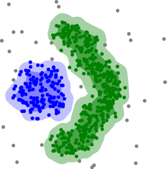

First, I would actually plot a two-dimensional scatter plot, just for a visual check. Next, I would suggest a non-parametric approach, a DBSCAN, or, if your clusters of "typical" users have a varying density a HDBSCAN.
Both algorithms are designed to look for clustered points in the data, and are especially usefull for a low-dimensional data. (H)DBSCAN will assign each point in your dataset either a cluster label, or a label of a noise, an "outlier" (gray points on the picture above), which is exactly what you want.
An alternative approach is an IsolationForest algorithm, it is designed specifically for anomalies detection problems. All three algorithms are implemented in the scikit-learn.
