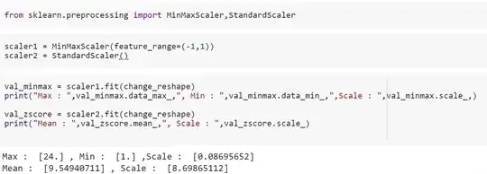

Consider a task that requires us to normalize the data. For example, we may use a min-max normalization or z-score normalization. There are some inherent parameters in the model. The minimum and maximum values in min-max normalization and the mean and standard deviation in z-score normalization. The fit() function calculates the values of these parameters.
Effect of fit()

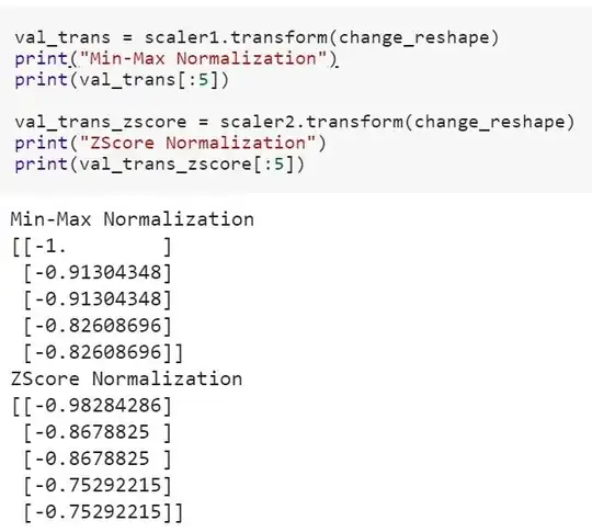

The transform function applies the values of the parameters on the actual data and gives the normalized value.
Effect of transform()

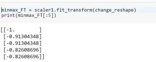

The fit_transform() function performs both in the same step.
Effect of fit_transform()
Note that the same value is got whether we perform in 2 steps or in a single step.
