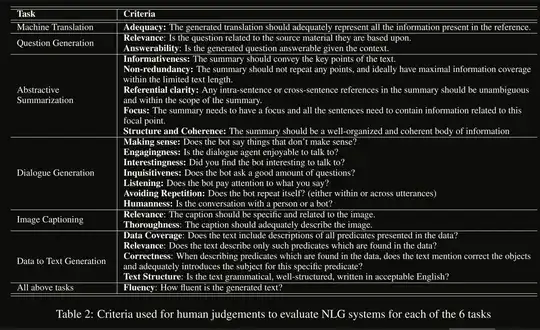

Since comparing the semantic similarity of the predicted answer with a reference question has some limitations, one may look at complementing the analysis with a human evaluation. The following papers survey criteria used for human evaluation of generated texts (thanks Mengjiao Zhang for pointing me to refs {3,4}):
- {3} A Survey of Evaluation Metrics Used for NLG Systems
- {4} Perturbation CheckLists for Evaluating NLG Evaluation Metrics (unfortunately, they forgot about QA)
From {3}:
