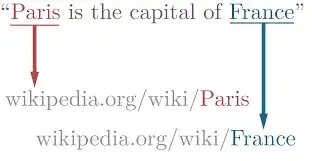

As depicted below, entity linking is linking mentions to entities/identifiers in a reference repository or knowledge base.
Source: Entity linking-Wikipedia

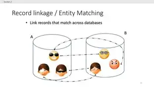

However, in entity matching the existing reference repository or entities in a knowledge base do not exist.
Source: Lecture 9: Entity Resolution
